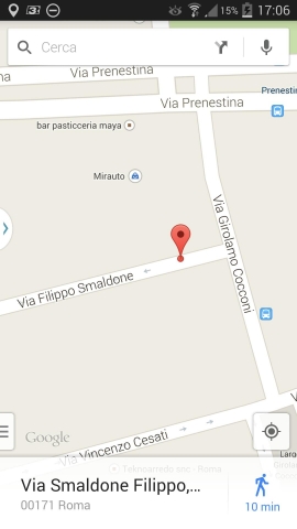

telemania
via filippo smaldone 103,
tel 0664829423
allego mappa.
https://www.androidiani.com/extra/im...mage_MeL5B.jpg
