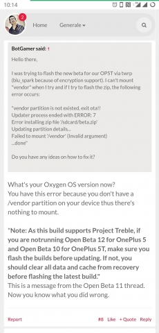

Ricordavo di aver letto qualcosa riguardo al passaggio su Treble Project. C'entra col tuo problema? (Vedi post nello screenshot da OnePlus Forum - sotto metto copia testo)
https://www.androidiani.com/extra/im...mage_sUoyG.jpg
Hello there,
I was trying to flash the new beta for our OP5T via twrp (blu_spark because of encryption support). I can't mount "vendor" when I try and if I try to flash the zip, the following error occurs:
"vendor partition is not existed, exit ota!!
Updater process ended with ERROR: 7
Error installing zip file '/sdcard/beta.zip'
Updating partition details...
Failed to mount '/vendor' (Invalid argument)
...done"
Do you have any ideas on how to fix it?
What's your Oxygen OS version now?
You have this error because you don't have a /vendor partition on your device thus there's nothing to mount.
"Note: As*this build supports Project Treble, if you are notrunning Open Beta 12 for OnePlus 5 and Open Beta 10 for OnePlus 5T, make sure you flash the builds*before updating. If not, you should clear all data and*cache from recovery before flashing the latest*build."
This is a message from the*Open*Beta*11 thread. Now you know what you did*wrong.
ONEPLUS A5000
Sì, probabilmente il problema è stato proprio quello. Quando Oneplus ha inserito treble era obbligatorio passare per la prima rom treble per poi fare i flash successivi 😉
