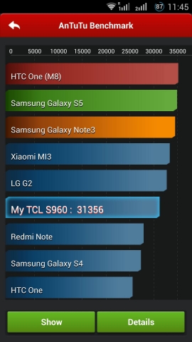

I could touch the ANTUTU score of 31205, with a Stock KITKAT and minimal GAPPs Package and my usual applications (about 35 apps). I am running seeder in Light RNG service profile. I did not notice much difference in scores when battery saving feature was enabled. The runtime is ART.

Here my antutu benchmark with latest rom 7.6 (there is no difference from antutu point of view with runtime art or delvik)
https://www.androidiani.com/extra/im...mage_3Lfi1.jpg
